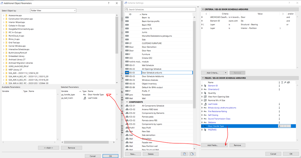

In schedules I can call this GDL property with gs_handle_type like so :
But for the marker there is not this possibility to call this kind of parameters (I believe a GDL Library part Parameters)

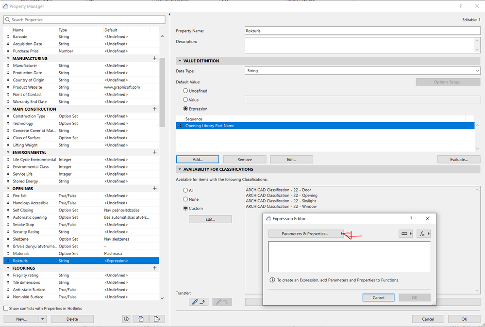

I was thinking to create a special property within property manager : and then call in the marker setting
But I don't see how to call such GDL parameter here :

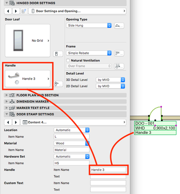

Ok, actually I didn't see/know handle was an option in content 4.
Made the change in GDL

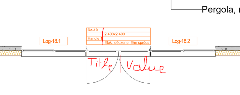

BUT in your proposition the value "handle 1" show in title row !
Is there a way to show only value ?
But you confirm that there is no way to call/request a value from GDL object as a property ?

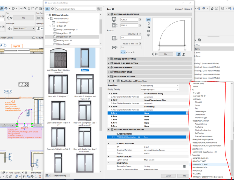

Nice solution.
It is easy to forget that Labels can display the values of IFC Properties, and you can map Library Part parameters to IFC Properties and display those in the Labels. No Properties needed.
