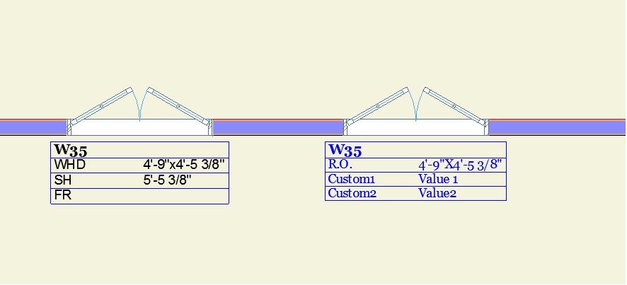

What I did was to create the text that I need in floor plan and then save it as an object>marker and let archicad to create the autoscript. Then I tried to "play" with the parameters but with no lack.... For example for the window ID the parameter that the autoscript uses is AC_WIDO_ID, which is a TEXT parameter and as a value has "wind-34". My mistake was that I though that there is probably some other parameter (for example: AC_WIDO_LIB_ID ?) that will use the library name of the object... You don't want to know how much time I lost searching....
Anyway, thank you for your directions, I'll try it within the weekend and see if I can get any results with the REQUEST function and the paragraphs->text blocks->richtext2 concept... Probably I'm gonna come back with more questions hahahahahaha

After spending a lot of hours trying to create my custom label I realized that my effort was hopeless. Thankfully I found that a prefixed archicad marker named "Window Stamp 17" was very similar to my needs (for some reason I had to download again the marker from graphisoft in order to work), so I desided to copy it and change it. In the attached image you can see on the left the marker with the default settings and on the right the marker after my changes (I will remove also the lines when it's finished but I left them ON for now so that you can have a better idea about the cells).
As you can see my marker includes:
1. Object ID
2. Rough Opening
3. Custom Text 1
4. Custom Text 2
(5)Custom Text 3 it's invisible because although I added it on the parameters I don't know how to add it on the master script.

I know I'm asking tooo much but if someone has the time and the mood to have a look, I would really appreciate it!!!
Thanks in advance
Does anyone knows where can I locate the code for each of the available parameters that archicad provides for the window schedules? Inside General Parameters there is a parameter called "Library Part Name" that does exactly what I need for my window marker.
Thanks:)
