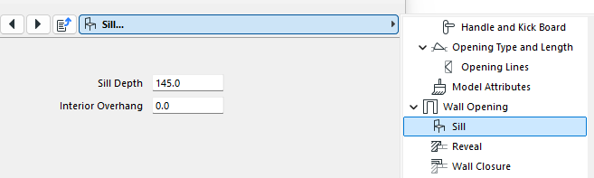

I added a basic sill to a bifold by adding a new BLOCK and WALLNICHE to the 3D script of the top level object. You could possibly do the same if need be if you know some basic GDL.
Ammended Master

ui_page TABID_GENERAL, 100, `Sill`,  "uiTab_Style_hl(1)"
gosub "pageGeneral"
!ui_page TABID_RETURN, TABID_ROOT, `Return Settings`,  "uiTab_Style_hl(1)"
!gosub "pageReturn"
"InterfaceEnd":
END
"pageGeneral":
unL = 1
IF gs_trim_outside & gs_trim_inside then
		ui_outfield			"Exterior Overhang",	10,		15+25*unL,	150,	20,	1
			ui_infield{2}	"gs_sill_ovhg_left",	170,	11+25*unL,	80,		20		: unL = unL + 1
	ELSE
		ui_outfield			"Sill Depth",	10,		15+25*unL,	150,	20,	1
			ui_infield{2}	"gs_sill_thk",			170,	11+25*unL,	80,		20		: unL = unL + 1
endIF
ui_outfield			"Interior Overhang",	10,		15+25*unL,	150,	20,	1
	ui_infield{2}	"gs_sill_ovhg_right",		170,	11+25*unL,	80,		20			: unL = unL + 1
return
