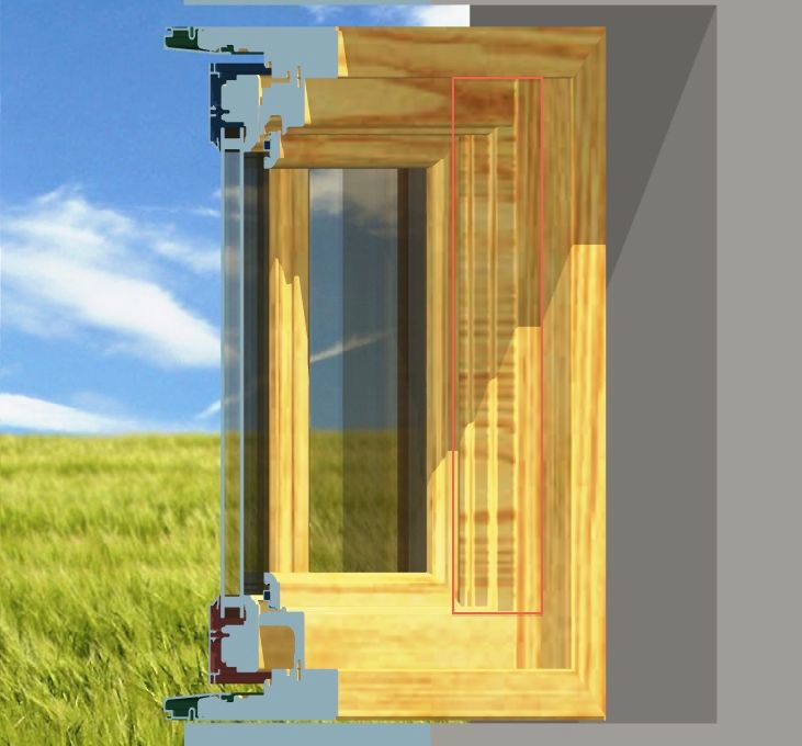

Texture problem on cprism

Any ideas would be appreciated.

Isolate the GDL script element having bad mapping.
Create a new material with the correct direction.
Add a material call for it to the script before the problem element
Add a material call after the element to return to the original material.

Thanks Dwight,
Still no dice. The texture is changing direction on a single surface.

The material in question is the one with the red arrow. The side surface of the cPrism.

Hello,
Could you post the object - would be easier to
rotate and test the texture orientation.
Thanks.
Thanks.

Thanks, I got it sorted out. The piece is a wood veneer over plastic and I just had them side by side. I grouped them together and the problem was solved.
Thanks again
