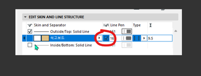

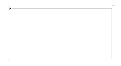

When I turn off the inner boundary line to turn the finish wall inside, a line like that comes out?

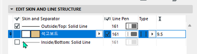

You can, just untick this and only one single line should be displayed.

I thought it was the same concept as this, but it's a different concept. Thank you. ^^
