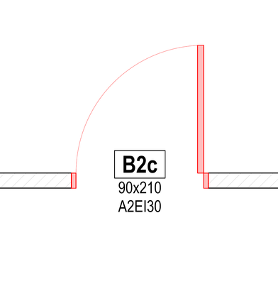

I would like to solve the problem of changing the color of the door opening line. I would like to highlight only fire doors in red.
In AC28, I cannot find the option to individually change the color of the door opening line in the door library element. Is it possible that GS removed this option from AC28, which was available in previous versions, and that the door opening line can only be changed globally?
I can solve it with GO, but it does not give the correct result, because it also changes the color of the wall behind the frame, but GO does not change the color of the door's consignment sign...

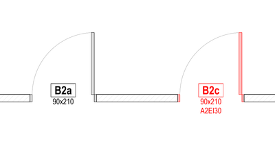

On the left is the normal door, on the right is the fire door, where it would be good if the opening line was also red for better understanding of the plan...
Thanks for your help.

Door/Window opening line colours are controlled in the Model View Options in 28.
Thanks Barry,
I know that the door opening line can be set GLOBALLY here in MVO.
I need a solution that allows me to modify this per door.
In AC26, there was definitely an option for this in the door settings!
Why did GS take this option away from us?
Did they need the letter to be different in the code 😁 ? For what?
Gábor
Versions 6.5 to 28, AMD Ryzen 9 3900x, 32GB ram, GeForce RTX 2070 super, Windows 10
I am not sure if the setting was there or not as I don't use the Graphisoft doors.
I believe that it was.
I just checked in 28 and I definitely can't see it now.
As I have mentioned to Graphisoft many times during testing, any object option that is in the MVO, needs to have an override option in the object itself.
We need to be able to choose if we want to use the MVO setting, or the individual setting in the object.
