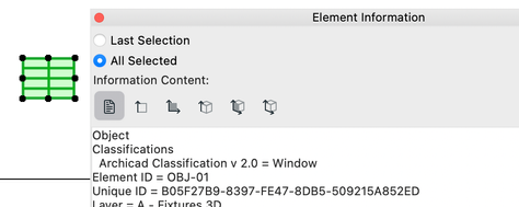

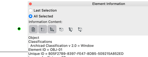

My thought on tracking down this bizarre behavior is to check the UID of the placed objects that report as 'missing'... my hunch is that a library update might have been applied which changed the UID, and even though it should match by name if the UID can't be found in the loaded libraries (at least from what I recall) - it obviously isn't doing that.
Here is a screenshot of a placed "Skylight Flat Panel" from the latest library update, with the Element Info palette showing the Unique ID for that skylight object. After that, is a screenshot of the same file, after saving with all libraries purged, and the "dot" representing the missing skylight selected...and the Element Info palette showing that, as expected, the UID of the placed object, missing or not, is the same. I'd be curious what the UID is in the staff member's PLN vs as you see it after re-joining and placing the same-named object from your loaded library, although at this late date, it's probably impossible to do that unless you archived those files...
