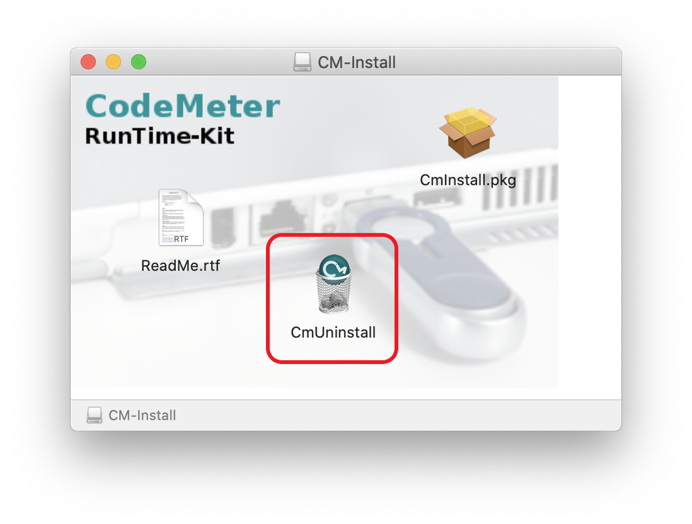

Step 2: Uninstall the current CodeMeter installation
  • On Windows 10: click Start > choose Settings. In the Settings app, open the Apps section. Look for CodeMeter Runtime Kit in the list and click Uninstall. The wizard will guide you through the rest of the uninstallation.
  • On macOS: Open the package in step 1, and start CmUninstall application to remove all CodeMeter components from your computer. In the new dialog, click Remove to start uninstalling CodeMeter.
Step 3: Install CodeMeter driver
Open the downloaded package in step 1.
  • On Windows: Follow the guide in the installer to install CodeMeter driver. Make sure to select the proper custom options when installing CodeMeter.
  • On macOS: Double-click the installer CmInstall.pkg, then follow the guide to install CodeMeter driver.
