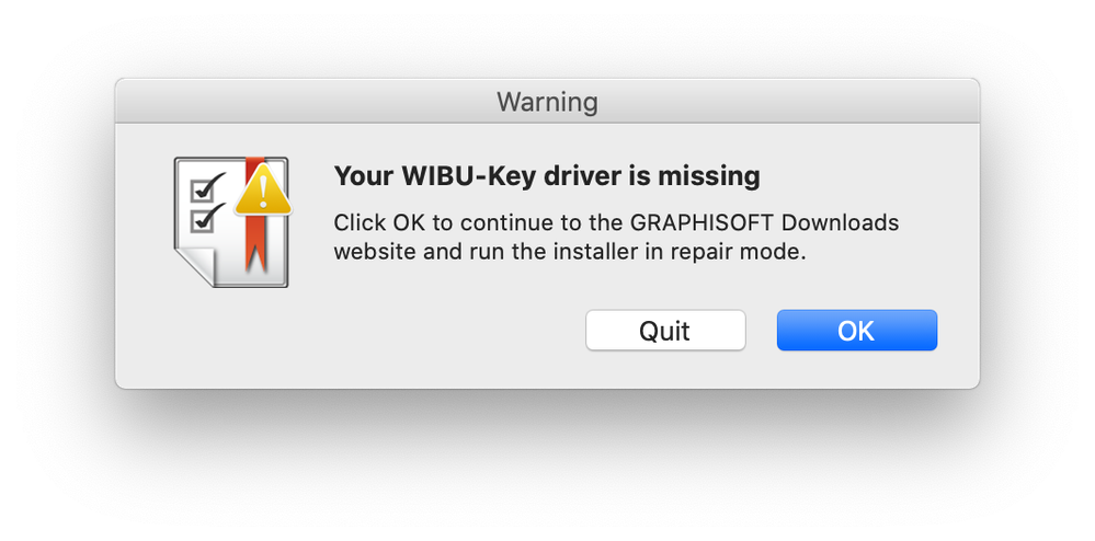

License Manager Tool startup process is interrupted on macOS 10.15 Catalina with the warning: Your WIBU-Key driver is missing.

When License Manager Tool is installed freshly on macOS 10.15 Catalina, the "WibuKey Runtime" component cannot be added. This compatibility issue prevents LMT from running.
Computers with License Manager Tool installed before the macOS 10.15 Upgrade are not affected by this situation.

Download and install the macOS 10.15 Catalina compatible WIBU-Key Runtime 6.52 from the GRAPHISOFT Downloads Site.
