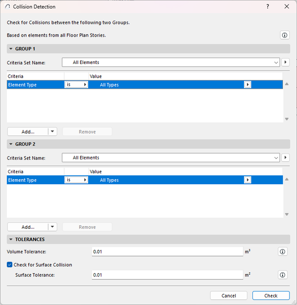

Collision Detection for MEP Design
The integrated collision detection allows you to check whether MEP elements intersect with architectural elements or other MEP systems. Early detection of design errors and conflicts helps avoid issues. This feature, found under Design > Model Check > Collision Detection…, supports coordinated, multidisciplinary project collaboration.
  NOTE: Collision detection considers element intersections. If material priorities cause an element to be trimmed/merged (for example, by building material priorities), no collision is detected.

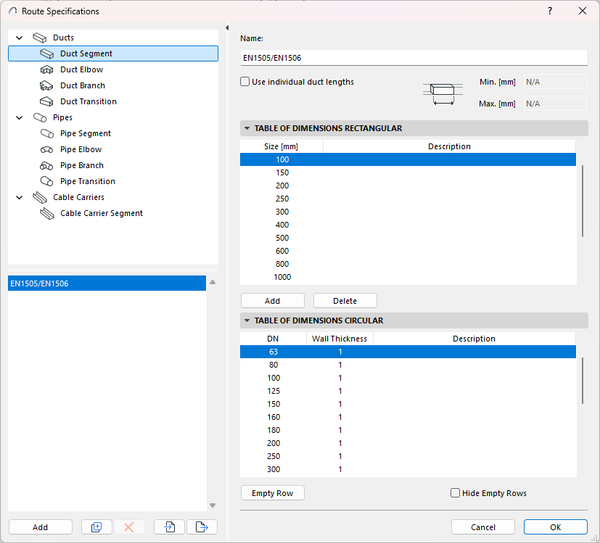

Central MEP Presets Management
MEP Presets define base properties and standard values—such as cross-sections, wall thicknesses, and lengths for pipes or ducts—for all MEP networks in the project. These ensure new MEP elements are always placed to project standards. Find these presets under Options > Project Preferences  Route Specifications…
