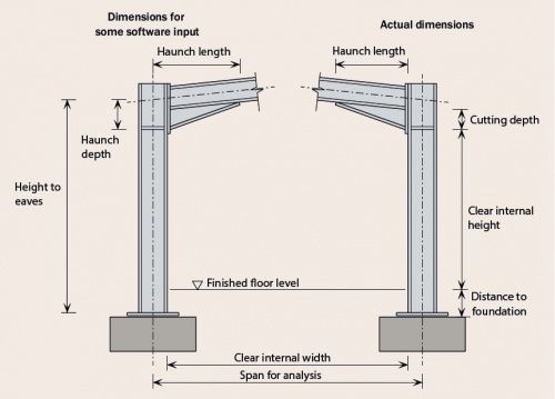

What are the best options for modelling steel please?
Beams and columns are fairly straightforward as far as I can see but my query primarily relates to the connections and details such as haunches.

That is an interesting thing to model because anytime steel frames like that are used, they are Engineered. And when they are Engineered, it is usually with Engineering Software for the sake of structural evaluations, so there are probably already Shop Drawings for it somewhere. Just not a 3D model of it?
So are you modeling this per steel shop drawings? or is this for modeling an initial concept that will be used in the process of engineering the final solution?
https://www.steelconstruction.info/Concept_design#Single_storey_buildings
