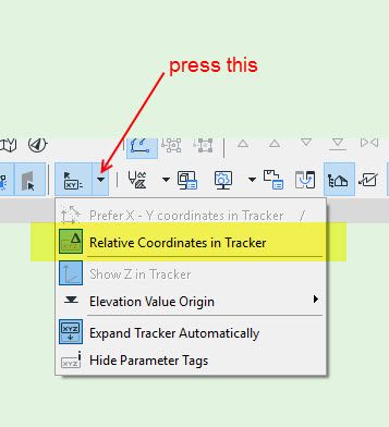

In the tracker options you need to turn on "Relative Co-ordinates in Tracker".
Thanks for the reply Barry, I already have "Relative Co-ordinates in Tracker" turned on. I have attached 2 images that might make it clearer what I'm talking about.
The snap guide angle back to the project origin seems to always appear, but the snap guide radius around the project origin only sometimes appears.
I see what you mean but I have not come across this.
The only time I am seeing a snap guide from the project origin is when I have set a snap reference there (blue circle).
Clearly there is not a snap reference there in your image.
Do you have the latest version of Archicad installed - build 5025?
Thanks Barry, latest build has fixed the issue for me. I thought it was a new feature, must have been a bug.
