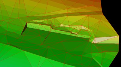

 This is a screenshot of my already created triangle surface mesh in Trimble Business Centre. It has been created using points AND breaklines, so it honors the top and toe of banks drains ets and things like retaining walls. This surface has been created by me from my survey data so it is the best representation of the site. I can export this in pretty much any format LandXML,DXF, DWG, STL....... if there is a way I could get it into Archicad ?

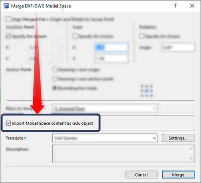

NandoMogollon
Try Merge for an Object with the Tin:
