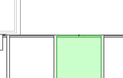

Hi guys. When i make kitchen furniture section not all of the body lines are showing? Is it possible to make all of the panel lines visible?

Just to provide more context, how was this built?
kbagbala
It was made using default ArchiCAD kitchen cabinets

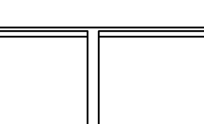

Looks like kitchen cabinets stacked next to each other.
I just tried and they merge in section.
But I don't use the Graphisoft cabinets, so am not familiar with their settings.
My cabinets do the same thing, but I have a solid fill in section, so have never really noticed.
Could be a GDL scripting issue, otherwise it would be a case of setting a different section fills.
With those cabinets, I think you have to override the section fill, as i don't see a setting in the parameters..
