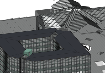

Hello,
I’m trying to locate the official download source for the Archiglazing add-on, which was previously listed on Graphisoft’s add-ons page (link). However, the page no longer seems to host it.
Could anyone clarify:
  1. Is Archiglazing still available for newer versions of Archicad 28?
  2. If it’s discontinued, are there recommended alternatives for ceiling/roof glazing modeling?
Thank you for your help!

Hi Barry,
Thank you for your response. I am considering too the curtain wall too, but i only find youtube turorials about the glazing tool, I have to draw something like this
 I do not know which tool will be better for the job.
I will contact my archicad reseller,
Thanks again.
Heftor

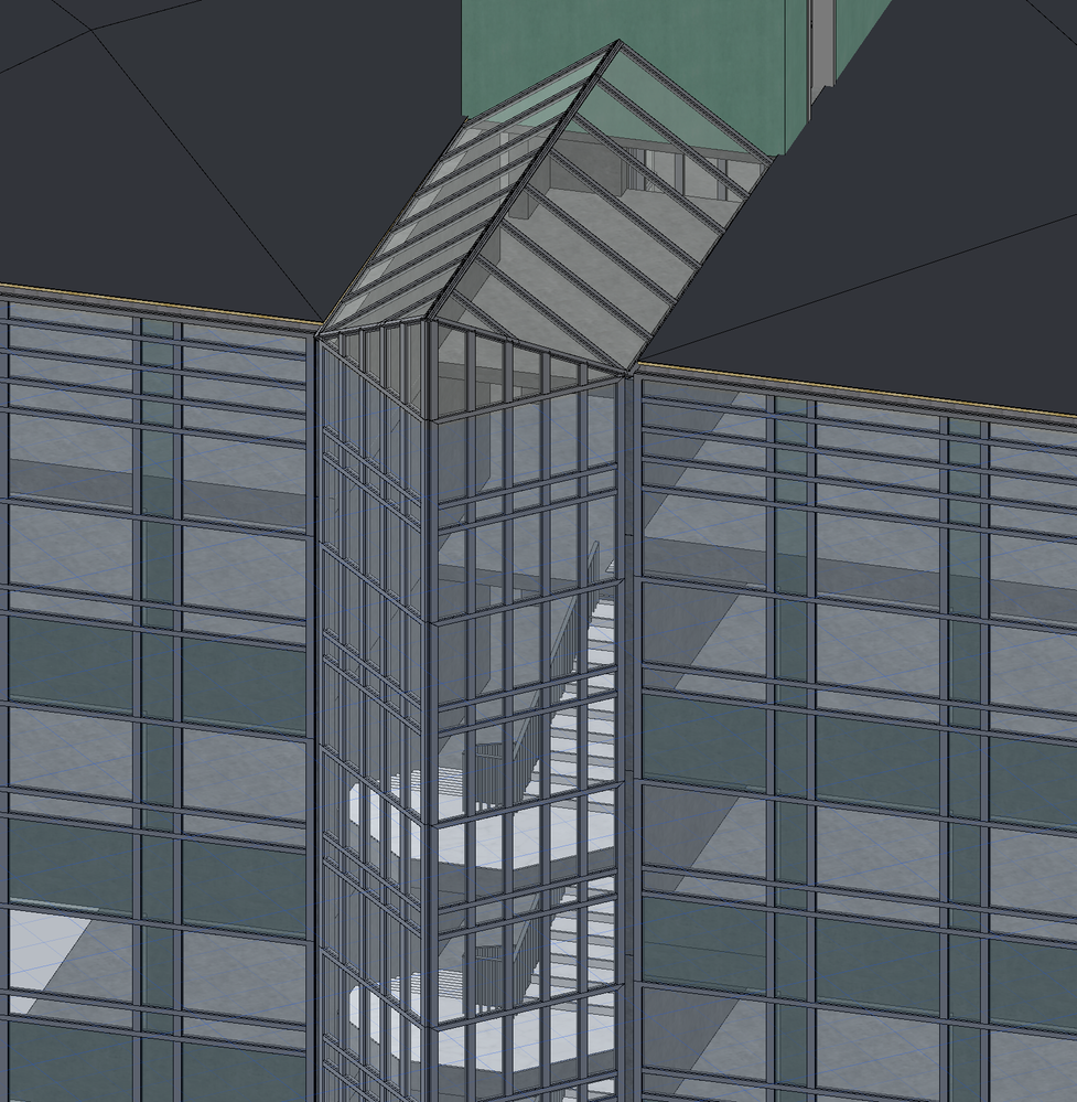

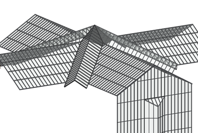

Hi @mthd,
Thanks for the info, first of all
I try with the skylight object at first but because it was connected with the curtain wall from the outside of the building I keep using the curtain wall tool.
This is how is looking right now:
Screenshot 2025-05-21 132922.pngScreenshot 2025-05-21 132941.pngScreenshot 2025-05-21 161929.png
The only thing are the connections between surfaces are not the smoothest in the world

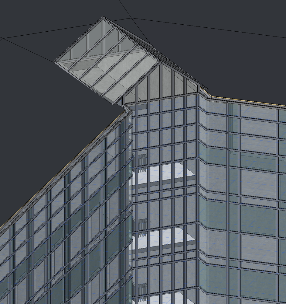

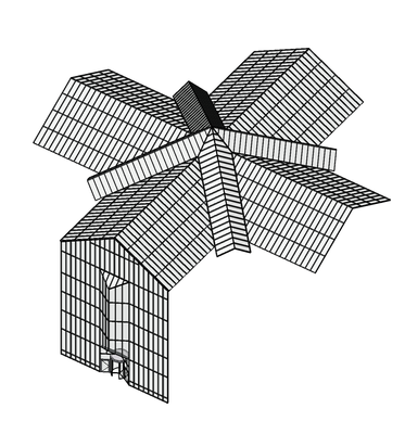

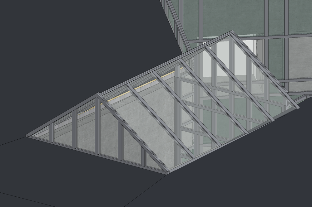

Hi @mthd
I was busy with another part of the building but i have time this week to work on the glass ceiling, here you can see some of the pictures.
I have tried with the the roof framing but i ended with the curtain wall tool in the end.
I will work on the small details from the glass ceiling but it's looking good.
Thank @mthd and @Barry Kelly for the help and the guidance.
