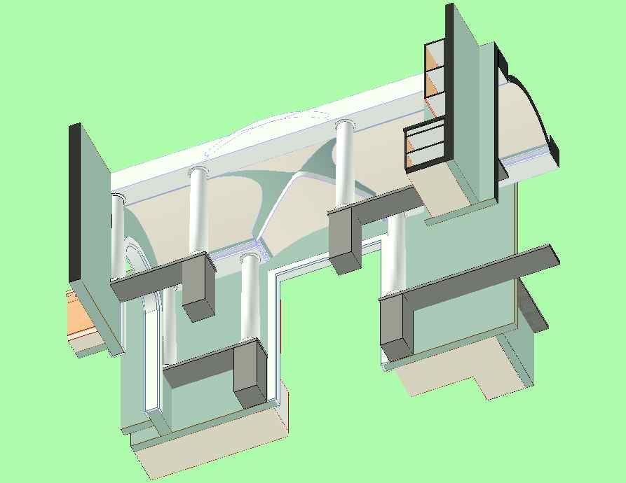

Have two barrel vaults intersecting. They are made from beam profiles, which is quick and easy. However, can't seem to get the SEO intersection quite right. Have attached a snapshot of the closest I can come; done with a substraction with downwards extrusion. Have tried every other operation, nothing seems to mitre the common angles as one would expect. The vaults are four inches thick, they have trim attached at the bottom as part of the profile.
Any comments?

BTW: Here's a shot of one I did with profiled walls when this same question came up about a year and a half ago. The vaults are assembled with two halves meeting at the top. I'm pretty sure I used walls but beams should work as well.
undefined
