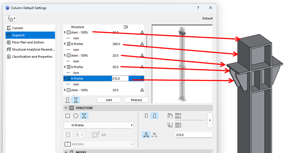

You can create some connections with segmented columns and beams.
You can even simulate the bolts.
But it may not be super accurate and not easy to do or manipulate if need be.
The above are examples that I have played with, but it is not something I actually use.

Barry, we have tried the segmented approach for columns similar to what you demonstrate but found that the level of manual input and management required to keep it up to date was prohibitive.
Ideally, we'd like to have an object that is hosted to the beam or column that had display controls independent of the main member but followed any changes in location.
