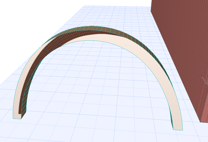

i've been reacquainting myself with Archicad after a few years of using other programs. After hearing about it's new shell and morph commands, i decided to give it another go. I'm currently doing my final year project where my structure basically consists of a series of large catenary arches, not too dissimilar from a brick viaduct. I would have normally modelled something like this on rhino/sketchup and the drafting in autocad but since time is tight, I thought I could kill two birds with one stone by using virtual building program such as Archicad. I was no expert using AC before so yet again I feel like a bit of a novice!
I have tried 2 different approaches to drawing the arches. The first was using the shell command and extruding a spline profile to form the arch, then lifting it upright and moving it into a straight brick wall of the same thickness. I then used the Trim Elements to Shell command to form the arch opening in the wall. http://postimg.org/image/tbbmjb8uf/
This seems relatively straightforward but my main problems is trying to align a brick texture to follow the line of the arch. I would maybe like to use the sketch renderer but cant get the proper textures on the arch.

Thanks Dwight,
it took me a while to model the arch as you described but it looks well. The only problem now is a noticeable drain on my memory and processor when placing them due to their size and complexity. Considering i'm using dozens of these in my building i might be selective and only use them in my renders and use the plain flat edged arches everywhere else.

You've modeled the individual brick units, now go back and model the grout as a simple, single block. Put the brick arches in a special layer toggled as needed, swapping the basic form defined by the grout blob for routine views.
You can also render the flat face of the arch and use that as your hi-res texture map. Use the 3D Align tool to make it fit.
As to math, the catenary is defined by: y = (cosh(1) - 1) x 2 + 1 so Mooseman should have no problem fitting that into a twelve line GDL script. [joke].

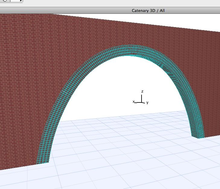

I've applied the material but for some reason can't align the texture.
Am I right in selecting the element then Design>Align 3D Texture>Set Direction? When I do this, it asks me to click on the main surface of the selected element, which I do and then nothing happens.

I've duplicated the condition and find no problem mapping or aligning to the side of a complex profile arch. So i think your mousecraft needs work. You've got to hit a place on the material surface - a node is best - to change the alignment. Also know your exact size since the mapping assumes 1.000.
Another way to do this is to make your object surface start at the origin - where all object mapping also originates.
I think you want to Set Origin, not Set Direction.

I have set the origin already. I think I have it now, I just cropped the rendered image of the arch to make sure the origin would begin right at the base of the arch. The new arch texture does not appear in the sketch renderer but I can render the previous custom arch with the individual bricks for that if I need.
