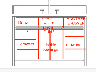

Hello! could someone help me please to customize the archicad cabinetry? I am sure I must be missing something because I can't explain otherwise this nuance?! No , I know it can't be real.
I am trying to build SEVERAL segments/cabinetry openings into ONE single cabinet... No I don't want to build 3 cabinets that is nonsense also because the sink would overlap in the side cabinets.. anyway.
Attached is photo of what I am trying to accomplish
1. top row : Left drawer, in middle panel since it is under sink, right side drawer
2. under: left 3 drawers, middle double cabinet, right 3 drawers.
( so far I could only accomplish one drawer on top, and double doors on bottoms but that is not what I need?
That is it!  Please please spare me of this nightmare. Please don't make me model this.. :((( I am using archicad 27 (yes archicad 27, 27 years and still workarounds :D.

I don't use the Graphisoft objects, so I am not too familiar with them.
But I think at best they can only do a double door cabinet, maybe with a drawer above.
I would say you would have to build that from 3 separate cabinet units.
Maybe with a separate splashback judging from another of your posts.
If you need to use this again in other files, you can save it all as a module (MOD) file.

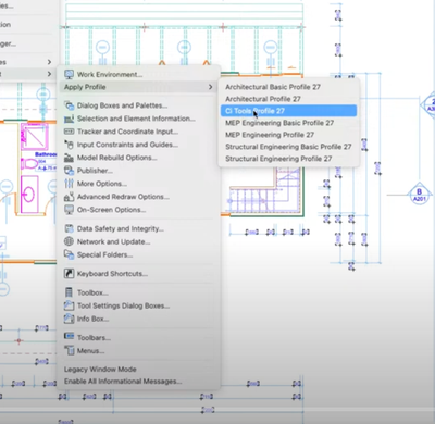

I just quickly opened the video and yes that would work as the cabinets looks like they have zillions customizations! BUT where to get these cabinets? 😄 It does not look like mine in the built in archicad library, and I don't see any link at that video for download. Could you please please elaborate? It seems like it could solve my problem
I see that he applied a cabinet tool - which I don't have. He said to find it through work environment - apply profile - Cl tool profile 27 - which I don't have neither?!! How is this possible???

I think the thing about any complex design element is you can't use a one size fits all solution.
Example: the stair tool works great for basic stairs, but if you ever find you have some feature, nosing, winding, turning, custom tread, etc.; it's best to model with slabs, beams, columns, roofs, etc. Or augment the OOTB stair with said elements. While you can likely get the stair tool to do about anything you need it to, there will always be some compromise to the intended design here and there and/or you will spend an inordinate amount of time fussing with it to get to the point where you just say "well, thats close enough".
The same applies to doors and windows, railings, cabinets, furniture, plumbing fixtures, etc. All these complex components are great out of the box, when "close enough" is close enough.
A custom cabinet like you are showing CAN technically be done with a single cabinet object; but there are going to be compromises when you start getting into sticking, rails, stiles, face frame positions, etc. Not to mention the door swing and drawer pull (the later of which is sadly still missing from our cabinet and MVO options) symbols, hardware options, etc.
From what you have drawn, I would use the cabinet object to model: counter, backsplash, sink, cabinet box, toe kick. Set the cabinet to open/empty, and model the rest with other cabinets or just slabs, beams, columns. I've even seen walls and doors used for cabinet components.
So if you just need a basic cabinet to get the point across; set it up with doors and drawers at approximate widths and positions and call it good. If you are designing (or translating shop drawings of) a custom cabinet package, it has to be broken down into components and model primitives.
