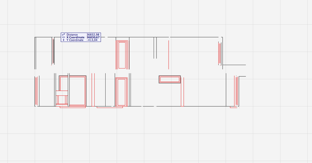

Can't see cut objects in my section
Could somebody help me with this problem.
When I want to create a section I only can see the uncut objects.
Thanks
2 Replies 2

Looks to me like you do not have certain layers on. Check your layout settings to be sure you have the layer combination you want as well as the appropriate Model View settings. You may also need to check your section settings.

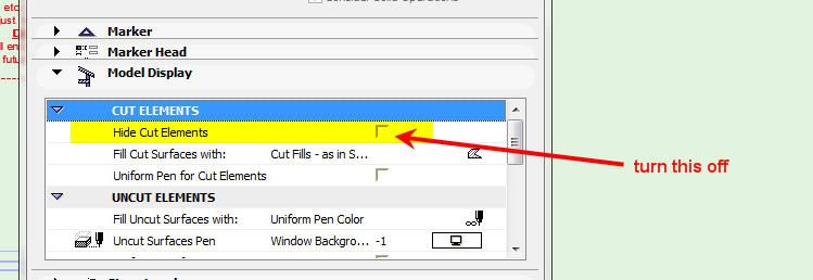

I just read another post talking about when elements go missing ... http://archicad-talk.graphisoft.com/viewtopic.php?t=47548
In it Link mention an option to "Hide Cut Elements".
It took me a while to find it until I realised it is an option in the interior elevation settings (I don't use interior elevations).
But I am guessing you have ticked this option by mistake.
