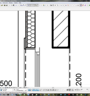

Complex profile problem; incorrect floorplan look
Please take a look at the attached pdf file.
I would be thankful for any solution for this problem but I think it doesn't exist (I mean the solution)
Best regards
Peter

The pen of end lines in Floor Plan are set in the Profile Manager palette. Select the fill and under the Component - Selected panel, below the surface setting you can set the end line pen.

thank you for your comment but the real problem is not about the line weight of the wall-end. My problem is that the line weight of the core ( which is set stronger in the Profile Manager than the other parts) is incorrect on floorplan ( only one side of the core is stronger, the other is lighter, as if it were covered by the other fills- changing the display order doesn't help).

It looks like your floor plan is using a different scale than your section.

Unfortunatelly this is independent of the scale.Here is another JPG just to demonstrate what I mean.
I missed the attachment.
Here is another version of the same floorplan-detail after that I pulled away the finish layers from the core in the Profile Manager. Amy other option is the same
