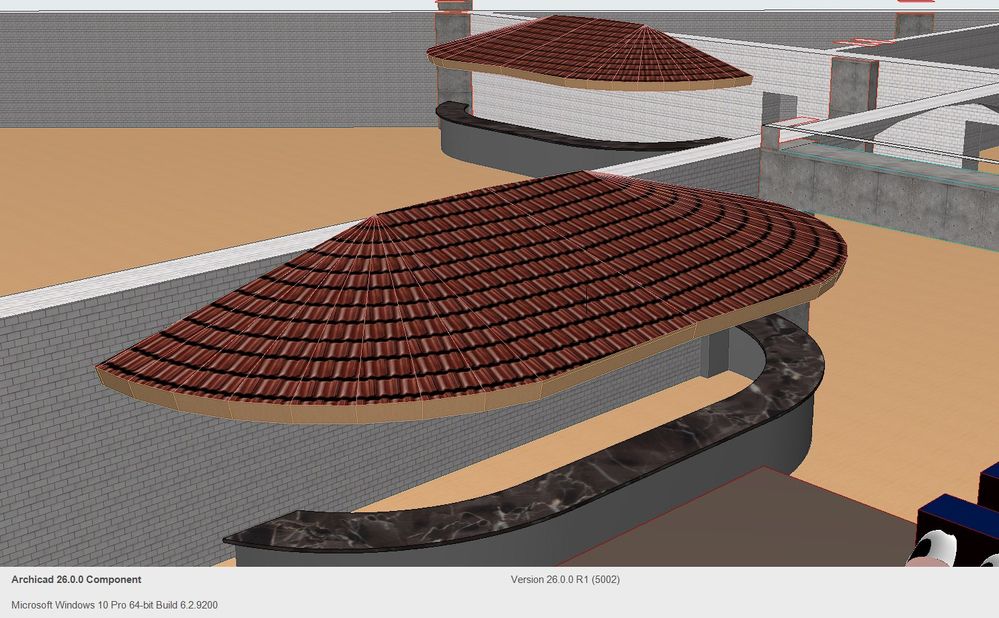

Today I am trying to essential create the same roof minus the "flat" section in the middle so that it would be half a cone with the point on the top. The following pictures show what I get today using AC26.
As can be seen, the roof tool sort of makes what I want but I can't seem to eliminate the slope on the back side of the roof. I tried the single plane style but it does not allow curved shapes. Using the multi-plane setting I cannot get the plane on the backside to be vertical. In addition, if I try to create an eave overhang on the curved section it automatically places the same overhang on the back edge (undesirable). I have tried using the Help files without any success. I know that I could create a cone with the "morph" tool and then cut it in half but that wouldn't provide any BIM data. I can also create a proper roof with rafters, sheathing, etc. with my 3D MCAD software but again no BIM data. Could some one provide me with the necessary instructions on how to create a circular roof that looks like a half of a cone? Thanks in advance for any assistance.

No need to split into separate roof planes.
Change the rear edge into a gable.
Move the pivot line in and reduce the eave overhang.
You can also do it for a dome end (semi-circle).
You will get slightly different results depending on the shape - extended semi-circle or exact semi-circle.
But all of the ridge nodes can be moved and the edges adjusted.

Draw a long rectangle polyline with the short side equal to the required diameter of the cone. Pick the mid point of the short side and drag out to the required radius to form a semi-circle at the end. Set up your multi-plane roof to the required pitch and apply zero overhang. Set curve resolution. Now magic wand the roof to the polyline shape. Use the context menu to "Split into Single-plane Roofs". Delete the unwanted roofs and if necessary on plan adjust the last roof segments of the semi circle to the arc centre point.

There is no need to "Split into Single-plane Roofs". With your "dune" roof, just select the reference line of the straight section, and under the Custom Plane Settings set it to Gable. If need be, remove and unwanted overhang using the Offset option.
