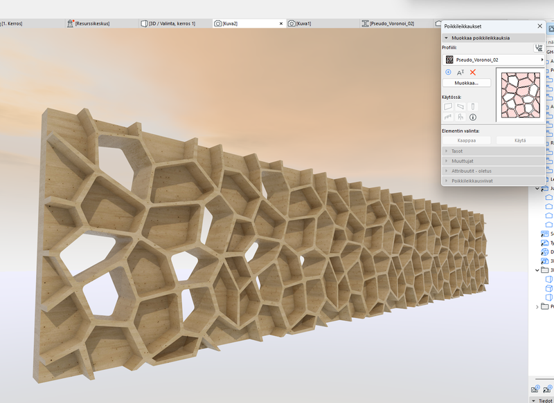

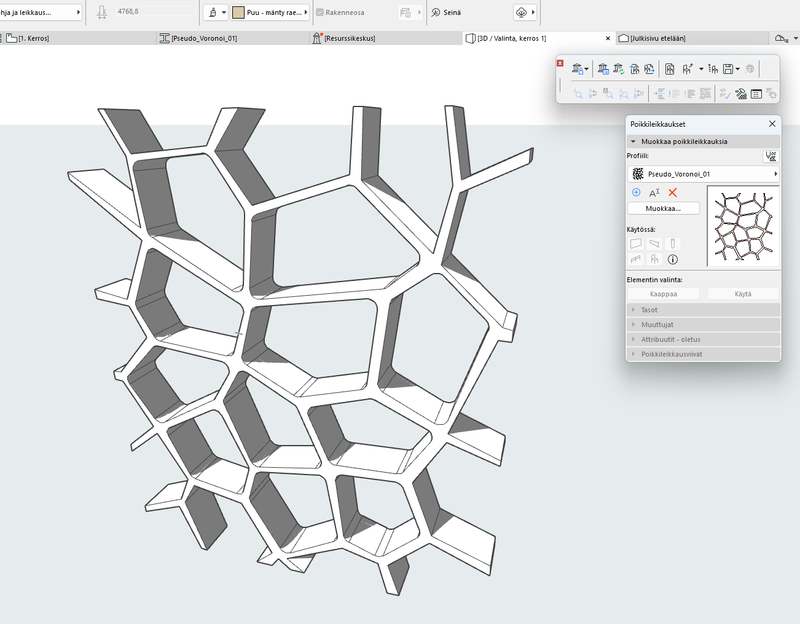

Definitely ArchiCAD Grasshopper connection, but if not, it could be achieved pretty easily with complex profiles. It would not be that easily changed or evolved, it takes a lot of work, but achievable with basic tools in AC.
I did not bother to line up the edges of the pattern to make the pattern run seamlessly from side to side. That would be needed to make a repeatable pattern out of it.
edit. tweaked a little bit, made complex profile mask layer to covet some holes like in your picture. Cloned a few horizontally, and rendered.

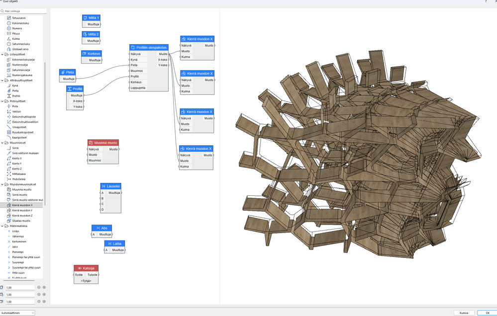

As for the original headline or subject line, you could now make a Param-O workflow/object and extrude your made complex profile according to Param-O programming. Rotate, move, or whatever is necessary for your design.
I tried to scratch the surface on this workflow, but unfortunately 3D representation broke on me in the Param-O 3D window. Maybe it's just the presentation but nothing more serious. Need to try to go a little further sometime later.
edit. I don't mean that repetition seen there is an error in 3D, it's not. It's the see through of the profile that is an error in 3D view. I did a multiplication seen in nodes, of 15 degrees (0, 30, 45, 60). That worked as it should of course.
