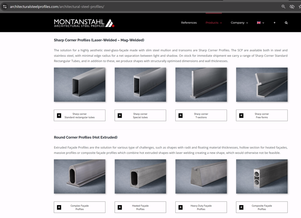

Steve Jepson
I don't see anything is those pictures you can't model with ArchiCAD easy enough.
https://www.wernersobek.com/projects/trumpf-canteen/
Excellent project for using ArchiCAD.   Below are some of the laser-welded steel profiles that were used in making that building.
