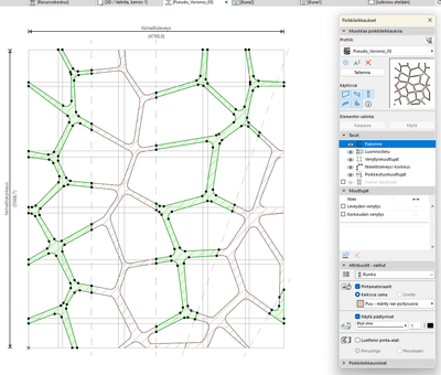

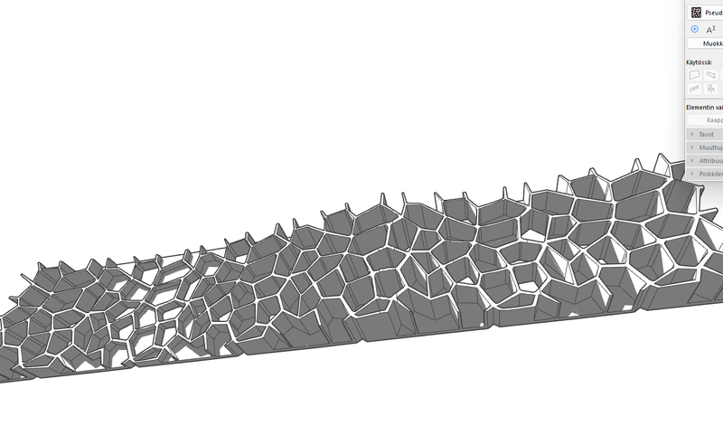

@cuba Really good point. The purpose is different indeed, and as in this case the AC-GH would be more appropriate, but not necessarily in some other cases, as in native object creations.
I tried to tackle this with Param-O, but got discouraged as I couldn't solve the breaking of my complex profile. It was broken as a saved object too unfortunately. I looked at the generated GDL, but I'm nor that proficient with it that I could see why it broke. I should probably send a bug report.
I read on the forum that the developer of Param-O has left the company, allready in early stages I think. Maybe they haven't found another one wanting to take over the project. Maybe it's not that trivial to jump in there. I don't know.
AC28, Rhino8+Grasshopper, TwinMotion • Mac Pro 6,1 E5-1650v2-3,5GHz/128GB/eGPU:6800XT/11.6.5 • HP Z4/Xeon W-2195/256GB/RTX4080FE 16GB/W11ProWS
mikas

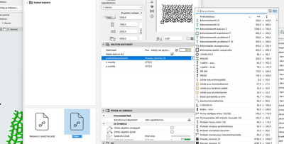

Ok, found out what causes 3D to brake. It doesn't survive the holes in the profile. Not a one hole actually. If I cut the profile fill in to pieces without holes in them, the 3D works ok in Param-O too. Some extra work, but good to know there is a fix to it - no holes in profiles.
Now I have my first, pretty rude but working, Param-O object. I can choose the profile and material, and can have matrix of 4x2 out of it. I should work on some variable inputs for bigger matrixes. Maybe later.
So I guess you can use Param-O for pseudo-voronoi style wall if that suites your needs.
