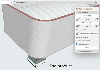

You could use a shell instead of a profile - its bendable for some cases like this. Shells can be edited (cutout holes and borders)) in the groundfloor-view (top-view when rotated) and can have multi-skins as well.
the other way would be a big enough morph-body for an SEO - command - intersection.
