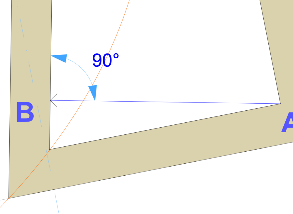

There is one thing about Archicad dimensions that I haven't figured out yet. I need to quote the blue line you see in the image. In fact, I want to dimension a line that starts from Point A and arrives ORTHOGONAL to the wall at Point B.
HOW THE HELL IS IT DONE? 🙂
As Geometry method, I have to choose "Any direction", correct? Well. But then? I can make the so-called "Mercedes Cursor" appear, but I can't make the dimension appear on the blue line, only on the wall of Point B...
Thank you

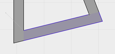

If wall B is vertical (which I don't think it is), then you can simply dimension the corners of A & B and place a horizontal dimension.
If wall B is not vertical, then before you start dimensioning, place a snap guide on the edge of wall B and a snap guide (circle) in the corner at wall A.
Now you can dimension exactly the points you want.
But note the dimension point perpendicular to the wall will not be associated.
But there is a way around that if you want.
Place 3 dimension points in this order.
Point 3 will be associated to the corner.
You will only get the one dimension that you want (points 2 & 3 overlap).
But if you move wall B forcing the corner point to move, then the dimension will show the extra node for point 3.
You can delete the un-associated dimension node for point 2 - leaving you with a fully associated dimension for points 1 & 2.

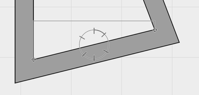

Assuming the left wall is orthogonal, start dimensioning from internal corner at A, then pick the internal corner at B. Hit the [DELETE] key to complete point entry, it should be now showing a Hammer icon for the cursor. Now move the cursor around, a circle will appear between the two nodes and you can select from a choice of predefined alignments including the one you want. Click to complete the dimension placement. You won't be able to position it exactly on the internal corner node, but you can drag the dimension into place after if that is where it needs to be.

Maybe we don't understand what your real problem is – or you did not understand what @DGSketcher explained, because that was absolutely correct and the solution...
Maybe you need pics 🙂
1) Click the nodes
2) Place the line. It's really that simple.
(MacOS doesn't show cursors on screenshots, there is now the "hammer" showing here)
