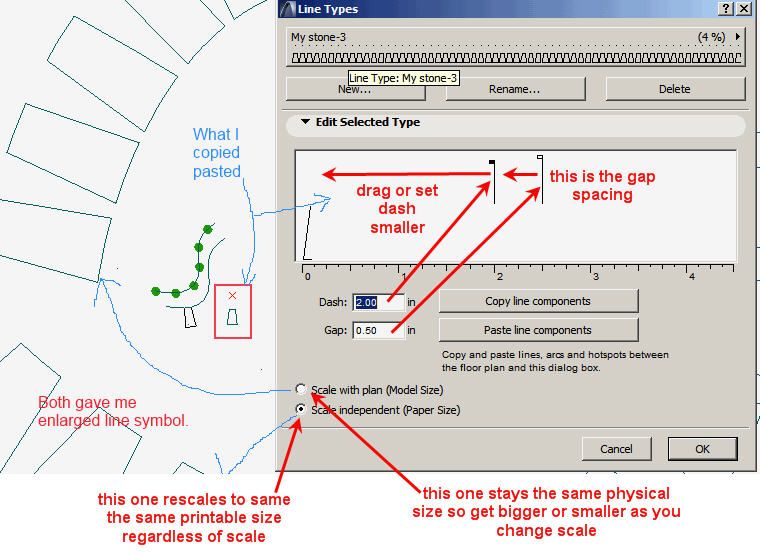

But the big elephant in the room for me is can't figure out why the shape size I copy pasted in to symbol line type gets so enlarged.
As you can see in attachment, I tried both scaling options with no change.
Am I missing the obvious?

You will want to adjust your dash size.
Currently you have 2" so that is how big it will appear on you plan at your current scale.
Not sure how your imperial scales work but if you have a scale of 1:100 then your paving should measure 200" (I think that is right).
You will probably want the scale set to "scale with plan" so it stays relative in size to your model if you change scales.
Thanks Barry
Having made a couple of line types before, (but not symbol ones), I did not suspect the obvious as you pointed out.
Thanks a bunch.
