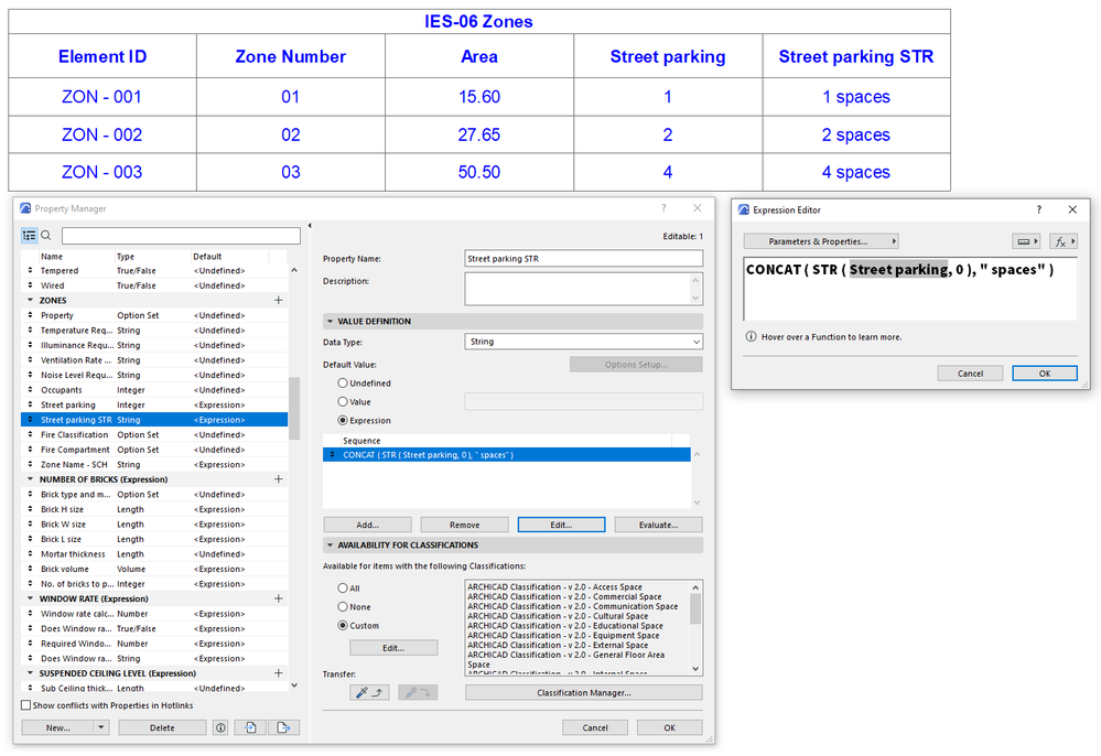

Expressions In Zone Stamp Rounded Number no Decimal
VideshN
Using the Zone Tool and Expressions to calculate parking bays..
Instead of 20,00 and 13,00 it should read 20 & 13.
i also would like to add text that says Bays at the end, to read 20 bays
Iimage.pngimage.png'd like the value on the zone stamp to not show decimal's is there a way to do this?
2 ACCEPTED SOLUTIONS
Solution
Make the "Street Parking" Property an "Integer" Data Type instead of a "Number" Data Type.
2x28" (2560x1440), Windows 10 PRO ENG, Ac20-Ac27
Solution
Actually, the whole thing can be achieved within a single Expression:
The exact Property Expression for copy-pasting it into your Property Expression Editor Dialog (triple-click to select it).
CONCAT ( STR ( ROUNDDOWN ( ( {Property:General Parameters/Area} / 1 m2 ) / 12.5, 0 ), 0 ), " spaces" )
9 REPLIES 9
Solution
thank you..
what about adding text after, eg. 20 bays
Use the STR operator to convert your Integer to a String, and then use the CONCAT operator to create a single String out of the number and the " spaces" text.
Solution
You are Awesome Thank you so much!!
This was Great!
VideshN
CONCAT ( STR ( ROUNDDOWN ( ( {Property:General Parameters/Area} / 1 m2 ) / 12,5; 0 ); 0 ); " spaces" )
The Windows Version.
It is an operating system localization difference rather than an operating system version difference. I am on Windows too, but use another localization setting.
Your system is using the , character (comma) as a decimal character, while mine is using the . character (dot). Thus, in Property Expressions, your system needs to use the ; character between parameters, while my system needs to use the , character.
I see, thank you..
