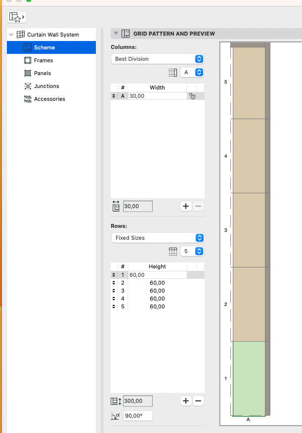

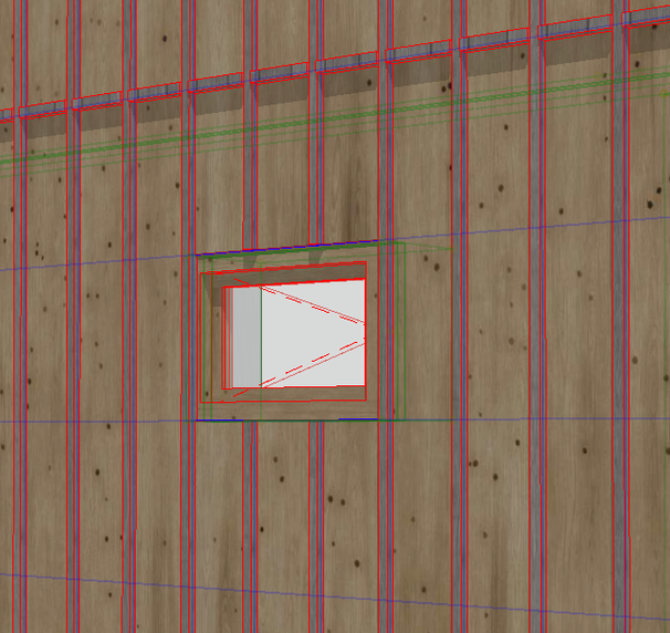

You could also use the curtain wall for this...
Set up a grid with best division and a vertical grid that you can align on the windows.
Edit the curtain wall to make openings for the windows....
