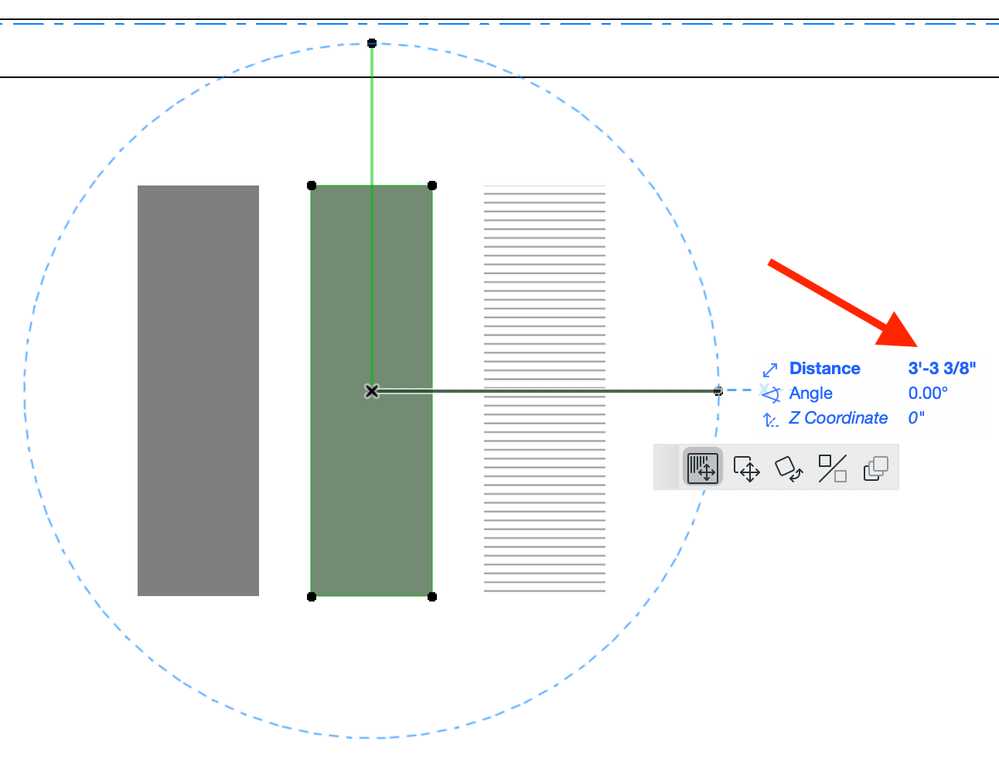

Is there a global setting that establishes the base size of any given fill?
When I use the Fill tool, I find I need to constantly select the Custom Distortion option in order to scale a variety of fill patterns.
And, when I first click on the fill to start that adjustment process, the dimension of both x & y are set to 3'-3 3/8", which is an exceptionally weird number. I guess it's anchored to 1 meter, despite the US units of the template.
Can this starting scale for the fill be modified? Where do I find that setting?
[Or, are we limited to modifying Fills by their individual scales in the Fills dialog?]
Thanks!
mac ACv29/3200, US, Tahoe26.1, iMac/2025 Mac Studio

cuba, would you mind showing a screenshot of a fill immediately after selecting the Custom Distortion option with the dimensional default showing?
like this:
This is what I see as the default "size" of any Fill when I select the Custom Distortion option.
My irritations are twofold:
1) it's a very large dimension for zooming out of a small detail drawing to access the click points
2) it's just a weird number that isn't useful in any way. A "whole number" like 1'-0" could be used as an easy base to scale to different sizes more intuitively.
If I can change this initial size, I'd be exceptionally excited to do so.
Thanks for your reply!
