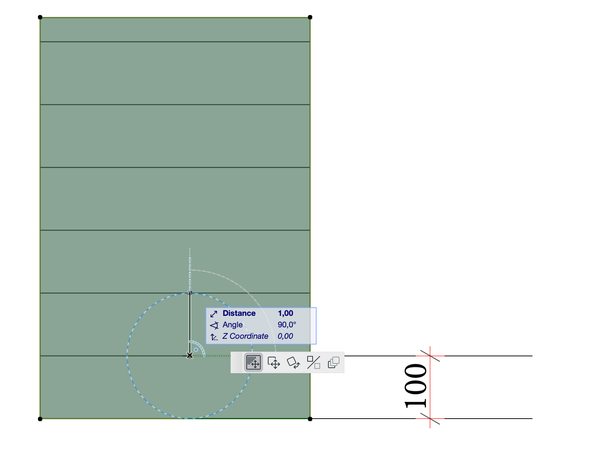

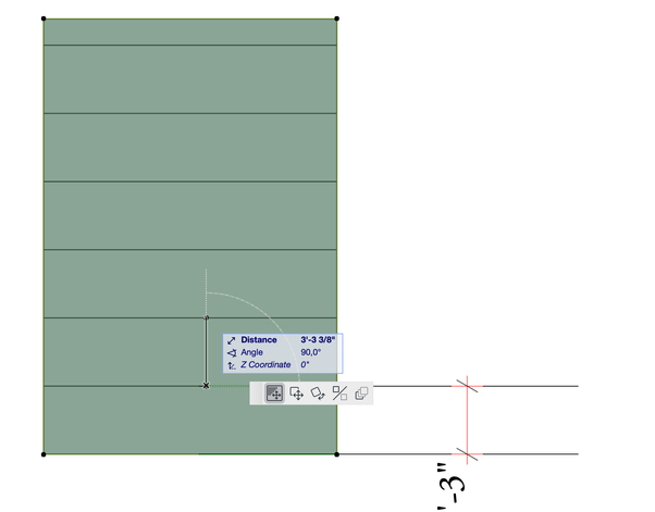

3'-3 3/8" = 1 meter
I think your base template, including the fills, was originally set up using the metric system. This depends on which template you use (as provided by your distributor). Graphisoft works with local distributors in each country, who usually supply a template that best matches local standards. You can also create your own template or look for an alternative one.
Preference set to meter (object/project preferences/working units)
Preference set to feet

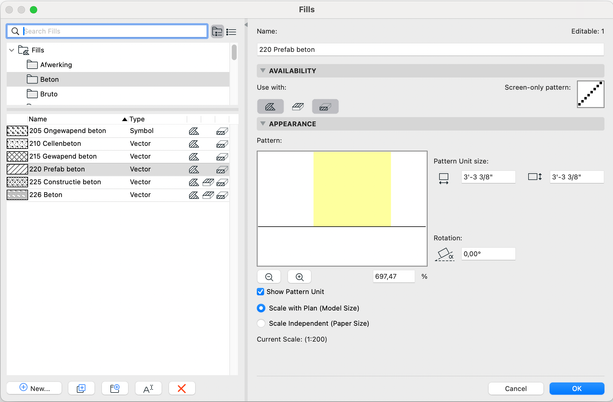

You can set the 'base' value to 3" or whatever you want.  It is the size of the yellow square in the fill settings.  (Options/Attribute elements/Fills)
