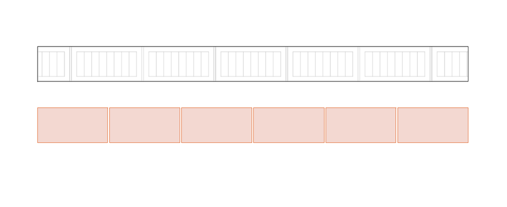

Marszel91
Hi everyone!
I think I am fighting the same problem. I would like to show how order of the blocks in my wall, so I have created my own fill, and I used it for the building material (with the fit to skin option), so it follows the direction of the wall. Unfortunately, the wall does not start with the full block, which is my goal, so I guess the material, fill, or the wall has to refer to another origin?
so this is how it presents the wall right now - grey is modeled wall and orange is a quick sketch how I want the blocks to be organized.
