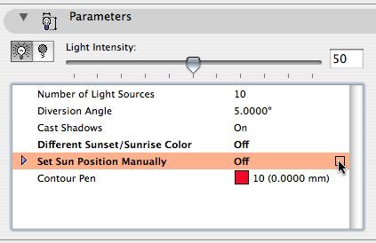

Related question; A view set of any 3D projection (axo or perspective) will remember the position of the sun and the rendering engine used. When rendering in Lightworks, the sun and sky objects are the preferred light sources. Their altitude and azimuth are set manually in the light settings dialog box depending on the desired effect on the projected view. Q) Is there a way to automatically re-set the azimuth for these lighting sources based on a view set definition? In other words, is there a way to have the sun object's azimuth automatically change when a different view set of a projection is selected?
and to return to your question scott:
if you set your sun/sky objects so that 'Set Sun Position Manually' is switched OFF, the sun object will take the azimuth and altitude from the archiCAD sun settings . . . which are saved as a part of the view. does that help?
limitation: in order for the sun/sky objects to update to reflect the global sun settings they need rebuilding. if they are not in the current floor plan when you double click to access the saved 3D view, the chances are they won't be updated . . .
~/archiben
