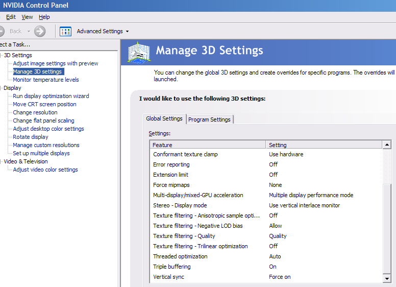

Yep, I believe I'm working in OpenGL. My 3D Window settings are attached.
As for updating drivers... Well, I've had nightmares with updating nVidia drivers when I last tried to do it, with them frequently showing blank screens in the AC 3D window. Finally went back to an old "officially recommended for AC12" version (v6.14.11.6921 5/12/2007) and haven't had any problems with blank screens since.
My Nvidia Control Panel settings, attached.

tell me man...do you use glases for stereo 3d mode ?
If not - its selected in your nvidia 3d setings !
disable that and try !
stereo display mode - TURN IT OFF
If not working then . . .
FIND on internet nvidia driver remover / search on 3dguru.com/
remove your drivers with that and try to install newest for your card
when you install them...adjast only resolution and refresh rate !
TURN OFF vertical sync / force off/
try then !

Necko: Thanks - I'll give it another try.
The "Stereo" setting is not able to be "off" - it's just a preference for what monitor to use if the app does stereo rendering.
But first - tell me, when you're racing around the 3D window in AC, do you exhibit the tearing too? (I just want to know if it is actually possible to get rid of it, before I waste any time on it.)

yes...i had that problem too...and its all about drivers of your graphic card
At work i work on ATI and i never had that problem
At home i have 9800 gtx and i had that problem
You are NOT supose to have that problem and there is solution for that for sure !
But plz try newest drivers and clean your system with http://www.guru3d.com/category/driversweeper/
i hope that this will hp you !
Uninstalled drivers -> Rebooted into Safe Mode -> Ran DriverSweeper -> Rebooted -> Installed latest Nvidia drivers -> Rebooted -> Ran ArchiCAD > 3D Window
This didn't have any effect. Still the same screen tearing
Nvidia Control Panel > 3D Settings > Turn on Vertical Sync > Close Ac > Open AC.
Still screen tearing
Of note: Any changes in the "Nvidia Control Panel > 3D Settings" do not take effect until the whole AC application is closed and re-opened. It is not enough just to close the 3D window and re-open it.
Well yet again, the latest NVidia drivers turn out to be just bollocks. After my 4th lockup today, I'm going back to the reliable 2007 versions.
Every 3 or 4 months or so, I get a burst of optimism and download and install the latest nVidia driver. Every time, I end up de-installing because of unreliability.
Of course, the screen-tearing remains unsolved.
My next card will be an ATI.
