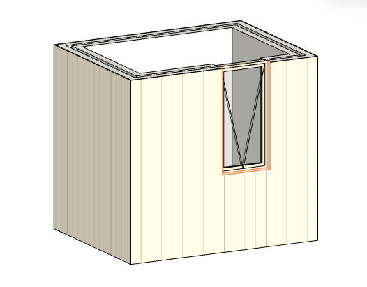

I have a CMU wall that will have an corrugated-insulated Panel installed on a CMU WALL.
the corrugated panels are created from a BEAM
I create the wall with a CMU wall that has rigid insulation as a part of its compound wall type an then another metal panel
I will place flashing on the corners
The section looks great but here is where I fail.
  • The top of he wall needs to slope - how to do this
  • I need to cut holes in the metal panels and cannot find out how to do that
  • I would like this to be a single wall so that it change size easily from project to project.
I wish this was a solid wall type so that doors and windows - opening as the such would work.
ADVICE IS APPRECIATED

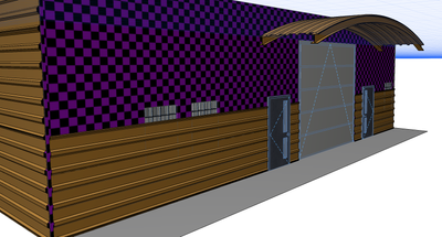

Did not help..  So far I am using the beam tool.  and have to morph to rotate the panel.  But then if the client changes the profile as there are a dozens+ profiles from the vendor.  If the profile is changed all panels must be rebuilt.

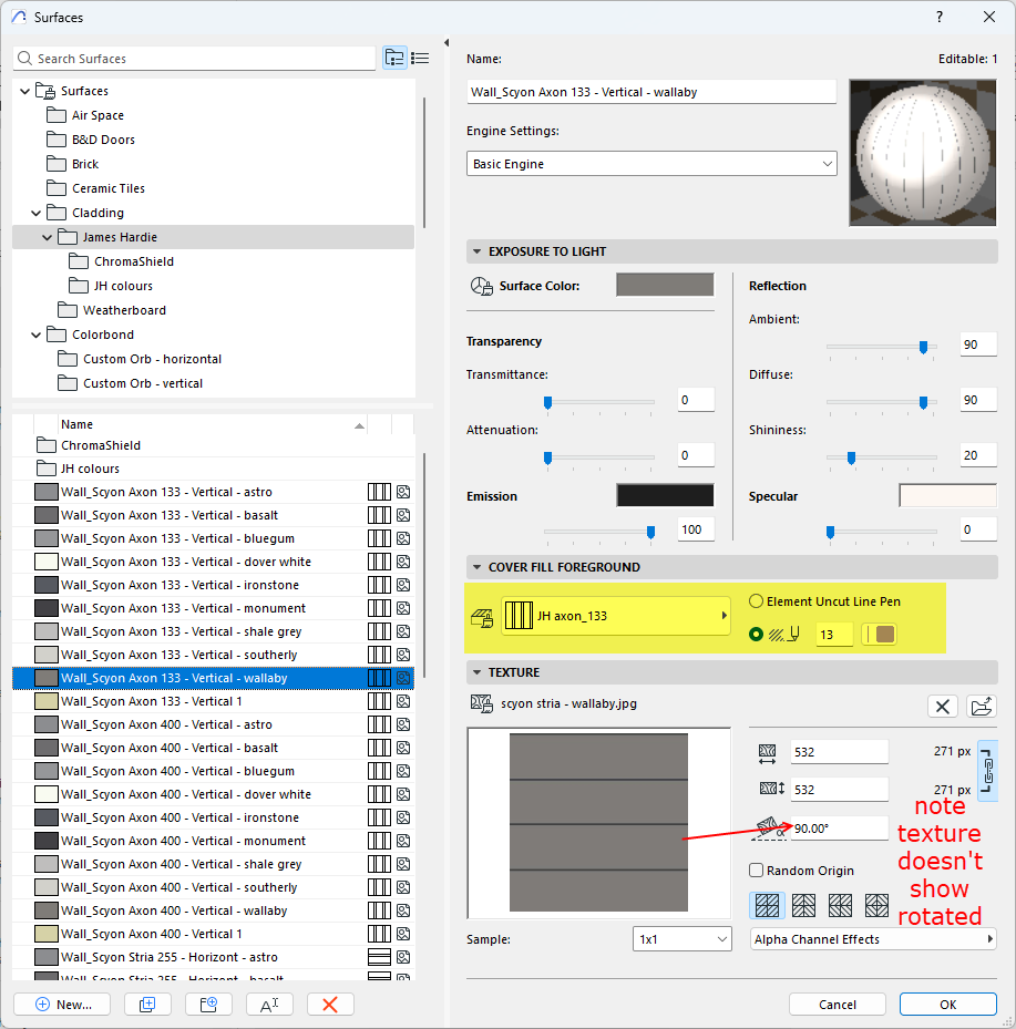

I would just create surfaces.
The fill (hatch) is what you will see in the elevations - you may need to create those as well to suit the pattern you want.
The image file (texture) is what you will see in 3D (note if you do renders, you will also need to make the Cinerender surface material settings correct).
Then you can associate that surface to a building material and create walls using those building materials.
CosminF
I am using the same method as Barry mentioned for large projects (it is way easier) from a polygon-count point of view. And it gets the job done and you can easily re-center the joints between panels or make them match a 2D vectorial hatch (for elevations for example).
Only downside would be that in section you cannot see the actual profile of the walls, but this can get easily tackled in detailing by drawing them "manually" in 2D.
