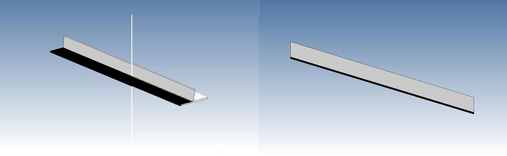

Hello: In my current design my building has some parking ramps that need to have a 3 foot wall down the middle of them (see attached pictures). Note that the black area is the ramp and the white is the wall. I have included both a perspective and a side view. Note that the ends of the wall are vertical with respect to the floor and not the surface of the ramp. While creating the ramp is easy adding the center wall seems impossible when using the "wall" tool. All suggestions welcomed.

Thanks for the 2 suggestions folks. I kind of got the impression that it couldn't be done using the "wall" tool so that makes it obvious that it would be easiest to use the morph tool (too bad as the dividers are walls). Unfortunately for me I can create a ramp and needed accessories much faster with my 3D modeling software but currently Archicad does not have the ability to import solid models. Again appreciate the replies and I will get to morphing my ramps.
