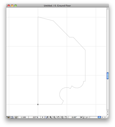

Step 1: Create a profile from Polyline on the Floorplan
In this example we create a traditional Hungarian profile from the 13th Century.
NOTE: Please make sure you are modeling with the correct size of the profile. In case your model won't be used as a simple 3D work for some rendering reasons but a proper ARCHICAD plan. If the profile is really small, please make sure in the next step the thickness of the Shell will be set properly. If it is a small profile the thickness should be set really small to avoid incorrect view of the Shell.

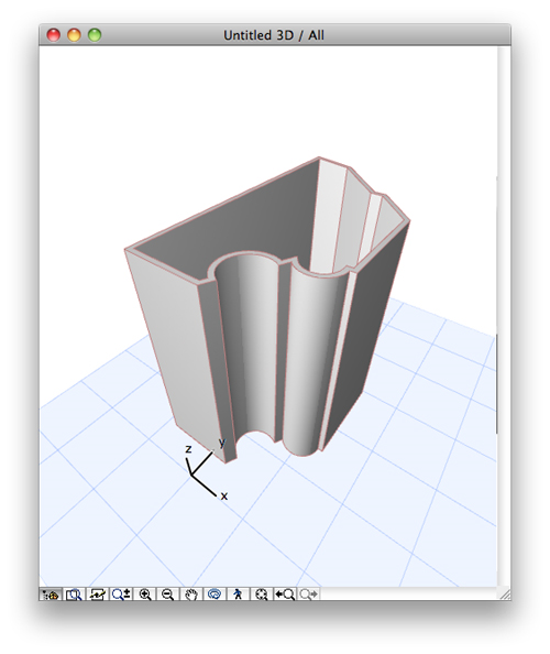

Step 2: Create Shell using your profile
- Select Shell tool
- Choose Extruded Geometry Method and Detailed Construction Method
- Find and trace the polygon shape with Magic Wand (press the Spacebar while clicking on the profile)
- Define the Shell's Extrusion Length.This can be changed afterwards with Edit Extrusion Length command.
- Check your profile in 3D. Use the Free Rotate command from the pet palette to rotate the profile in 3D so its extrusion vector becomes horizontal.

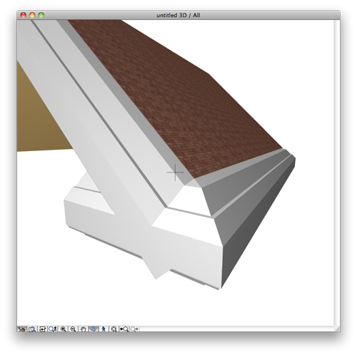

Step 4: Trim elements to Shell
- Use the Connect > Trim Elements to Roof/Shell command to have the corner properly done. Or you can follow an other workflow:
- Go to the Floor Plan and select the Shell. Choose Define Shell Contour (available from context menu) to use the contour of Shell so a 45 degree mitred joint is created at the corner. Do this command on both Shells.
- You can adjust the Shell in the Elevation to the roof's angle or even using the Free Rotate option in 3D.

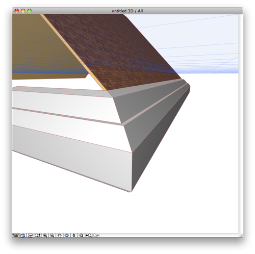

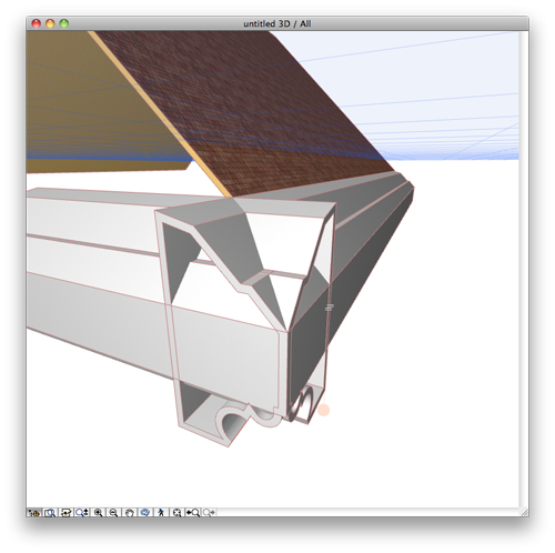

- The 3 Shells will connect in the same point so it needs to be corrected: Go to the Floorplan. Select the Shell profile and use the pet palette command to set the distortion angle graphically: Set Distortion Angle. Bring the profile into one line as you can see on the image below.
- On the Floor plan repeat the Define Shell Contour command on the slanted Gable side Shell and the bottom Corner Shell.
