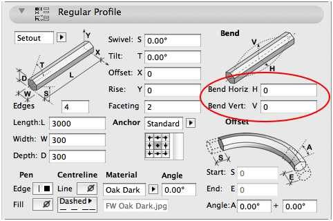

I'm trying to create the roof now, but when I use the regular profile then bend it using OBJECTiVE, nothing appears to change. Also, I I create a new profile (section) then bend it, I end up with a crazy shape For the example you posted on this thread, did you use the regular profile solely for this?

Yes, the entire frame is the same object (Regular Profile). You can do the same if you make profiled objects with OBJECTiVE.
Try an experiment first - just place a Regular Profile in the floor plan, select it, and click the menu OBJECTiVE > Tools > Bend. Does this work as you expect? If so, move on to a section and try it there. Note that bending can produce varying results if the plane of the section is different than the plane of the object, i.e. it will result in a combination of vertical and horizontal bending.
If you know the extent of the bending deflection, you can also enter the value directly into the vertical or horizontal bending settings (see attached image).
