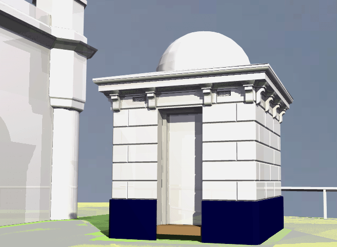

On a recently finished restoration project on the Byron Bay Lighthouse Precinct, profiler, solid element operations, and constructing library parts were all techniques used to create the models of the historical buildings.
It was decided to create the models of the buildings as accurately as possible not only to assist with the restoration but to also provide accurate records in the event of fire or other disaster.
An image is enclosed of the tiny signal house, one of the buildings restored, with bed joints extracted using SOE, cornice made from Profiler, vents made as library parts, etc, etc. The walls are actually slabs with the details added.
It was decided to stop short of laying blocks after discussions on this forum.
HTH.

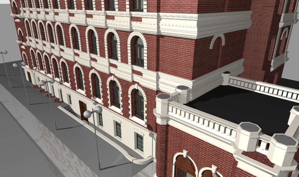

The question is: What for do you need this technical documentation. So, I've made it by transformations of primitives. Couple months ago I made a factory - neo-gotic. It's pretty complicated especially staircase are complex.

Our office works mainly with historic buildings in London. Attached is a finished model with some notes.
We usually build a simple body of the building first.
For detailing, some people in the office frustratingly still do 2D line drawings over top of these initial models. For small jobs where we have no visualization to do, this is is quicker, but I don't like this 2.5D approach.
Others (me included) model all the mouldings and window surrounds etc... using whatever tool best fits the purpose - roof, slab, wall, mesh, profiler and now, custom profiles, and the Solid Element Operations. I guess with the custom profiler we'll probably start building up a typical profiles library.
For creating good looking sections and elevations, we use a combination of layer control, fills covering bits that look wrong (I hate doing this) editing the GDL and sending things to the front or back of the drawing. I'll see if I can dig through the archives and find a section of the attached image to show you what it looks like.
This probably isn't the best way of doing things, but we don't seem to have any problems with it. And slowly the 2.5D people are seeing how a bit of modelling at the start can save a heap of line drawing down later on.
