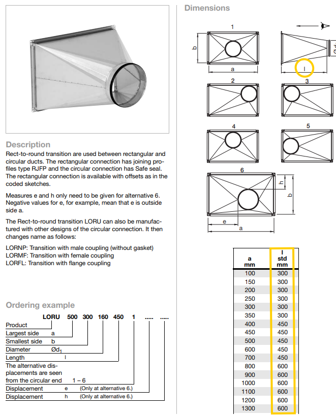

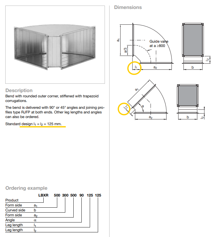

I’m trying to model rectangular HVAC ductwork using the new MEP Modeler with specific dimensions (see attached file).
My main question is: how can I define the inner bend radius (or the inner offset distance) of an elbow? How to a reduction specified by length, not by edge angle?
