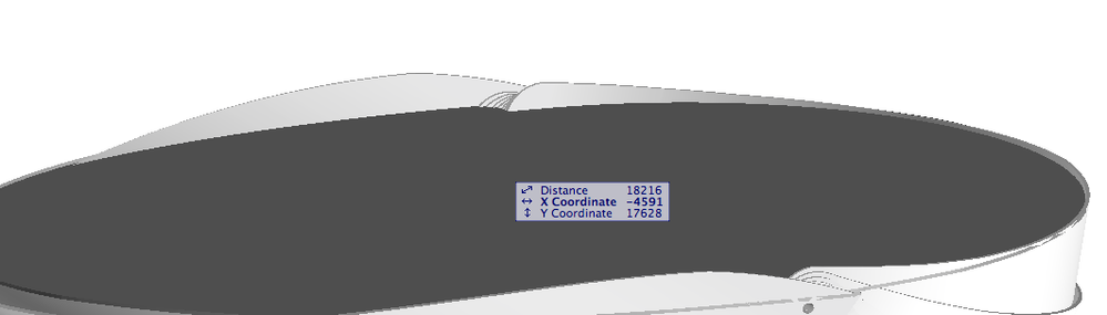

How to use the Level dimension and mesh tool ?
I would like to add a mesh to a curved wall, that also has a contour. The attached screenshot shows the mesh ( grey ) and the place of which it needs to be placed in white.
I know that the level dimension tool should work, but I don't get why, when I place the dimensions on, they either stay at 0.00 or a height that doesn't relate to the object.
Thank You !

The Gravity feature must be turned ON in the Standard Toolbar and it needs to be set to "Gravitate to Mesh". Then the Level Dimension will dimension the surface of the Mesh.

Yes I have. The level dimension didn't work, and I still can't get the technique Ralph Wessel showed to work... The mesh just will not snap to the object
The attached show what I've done...
Eric Bobrow
It looks like you're trying to make the surface of the mesh meet the top of the wall, which has varying heights due to it's profile.
I suggest you add more points to the mesh outline boundary, and manually move them (using the editing palette option to change the Z-height of mesh points) in the 3D view to align with the wall. You can't snap to the profile precisely, but you can zoom in and get each point as close as necessary.
