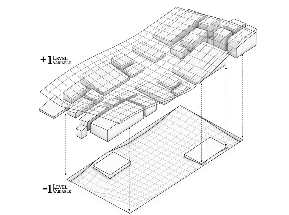

I wish to ask for an advice about approaching this problem:
I have two surfaces done in rhino, and I would like to translate it into Archicad. As you can see, upper surface is used for roofs of pavilions, while down surface is kept as a continuous landscape. First question is if it would be possible to use already existing surface from rhino, or you would recommend remodeling it in Archicad. If so, what tool should be used? I managed to get some "hills" with the morph tool, but I can not add thickness and use it as a slab (or am I wrong?). Any advice / tip would be welcomed. Also, if I have curved surface or slab, is it possible to display isocurves (contours, or izohipsys
Regards,
Petar [/img]

WhiteMan wrote:You can drag a copy of the Morph for the desired thickness, then use additional Morph surfaces for the sides.

Thank you your tip. Do you think upper roof surfaces could be modeled individually with the shell tool?

Petar:
It depends on the geometric complexity of the shape, the Shell Tool works for well defined shapes, the Morph Tool is more free form, see an example in this post where the Morph Tool was needed:
3 Curved lines 1 Straight
I would try the various Shell Geometry options first (Virtual Building > Construction Elements > Shells > About Shells), as they generate a thickness.
