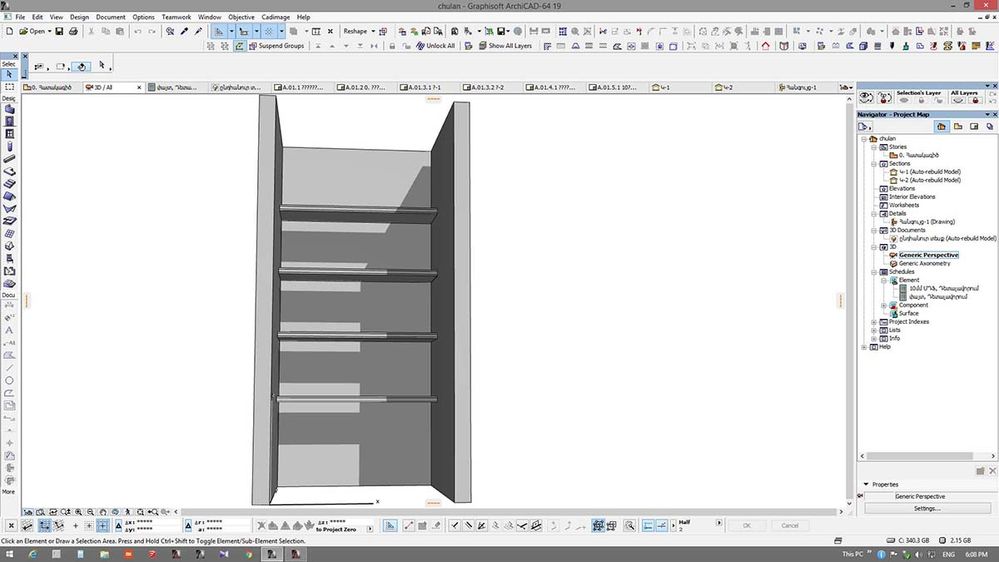

laszlonagy wrote:I am importing 200 furniture details. It is impossible to convert them all separately to morph,and then again to GDL. In ArchiCAD 18 the same file is rendered correctly. Maybe in future updates this will be corrected?
You can select the Morph and use the File\Libraries and Objects\Save Selection As\Object to re-save it as Object. Then you will again have the correct solid geometry in a GDL Object form.
