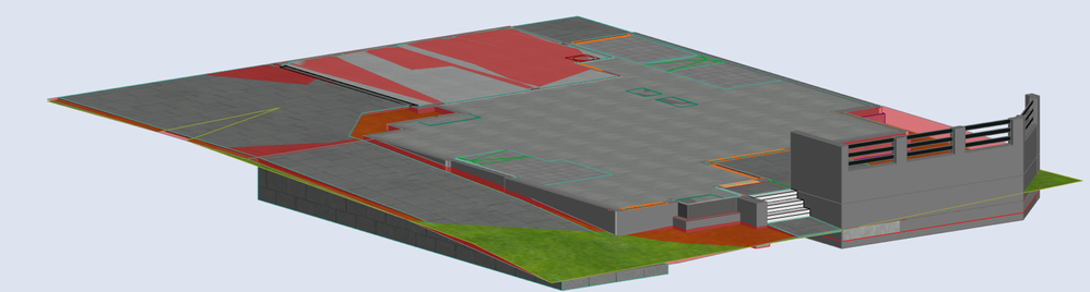

1. Is it possible to do a 3D cutaway with selected walls still showing at normal height?
2. My work around is to save it as a library part and then turn on the layers required to see the selected walls at the normal height.
But this means I have to constantly update my lib part and hope it doesn't move.

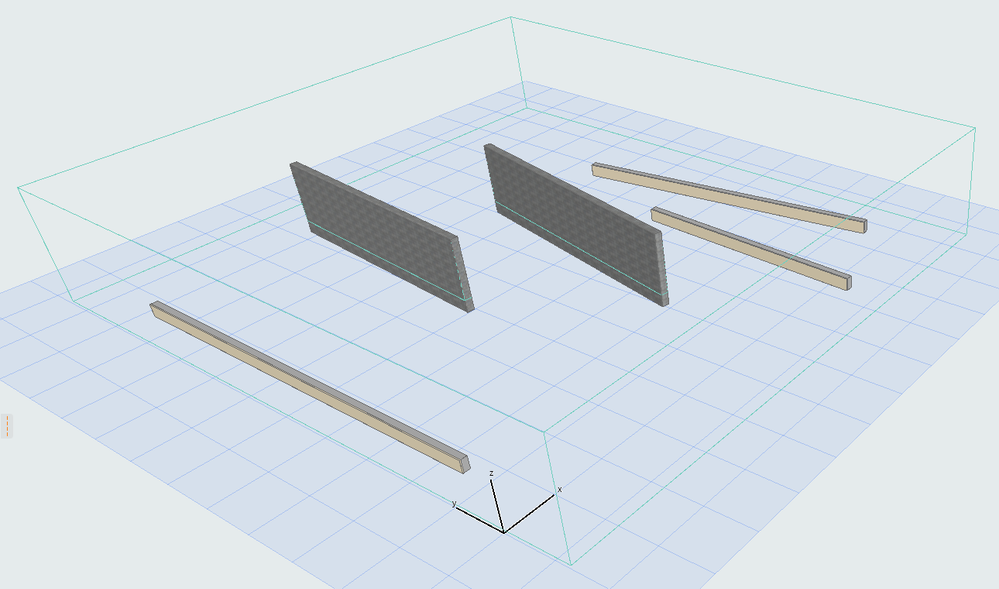

Hi, what would be the intention for doing that? for active work on the 3d window or for some 3d axonometrics to put in layouts??
Lingwisyer
Guru
What is the use case? I am having trouble understanding what you are trying to achieve... Is your screenshot of a horizontal cutting plane at your floor level, then your fence is an object?

It's mainly for 3D representation, in this case it's a combined layout of 9 units on a 2 meter sloping block "showing clearly in 3D" where the floor slab heights are and clearly identifying the screen walls that have a different footing.

Is there a need to show to walls cut off at the FFL? I would just turn off all the interior and exterior walls, and have the screen walls on a 3rd layer. Then, if you are multi storey, limit your 3D display to the ground floor and below only.
