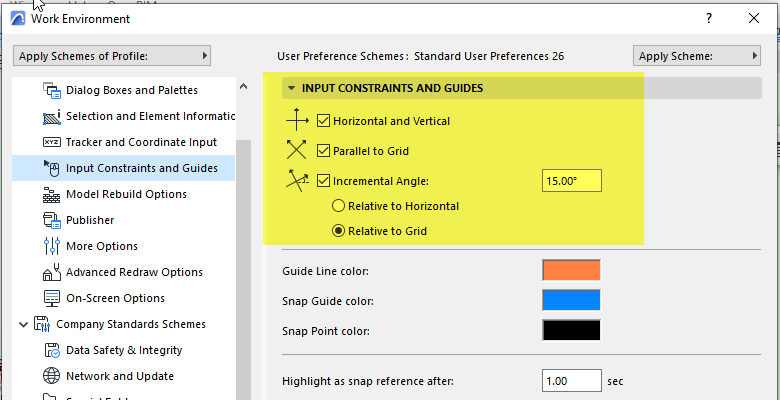

In all other versions of Archicad that I run (25 through 29), when I go to move an object, the angle can snap to 45 degree increments (as desired) unless I manually enter an angle. Somehow, I hit a key combination that turned this off in Archicad 27, leading to no angle constraints or snaps. How do I re-enable?
All of the Tracker and Input Constraint variables appear to be the same across all versions, but the others have the the constraints enabled still.

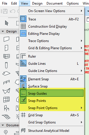

I don't have 27 on this laptop so these images are from 26.
The settings are found in the work environment.
But it sounds like you have turned your snap guides off.

Ridiculous Me had indeed accidentally turned off Snap Guides. Additional responses will make it easier for me to do some custom angles in fewer steps as well.
