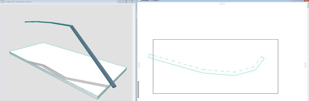

A generic beam/wall/morph-like tool that have different lines on the sides as shown in plan attach. It's for curbs'n'stuff. Anyone?

I use this. I calculated material start points too so they follow the curve.
How does it show in the plan view? I think I've tried this object sometime. Is it possible to download and test it?

it will show each point of the profile poly line as a line in plan view.
It does not allow for different line types but this can be achieved easily with a simple algorithm.
