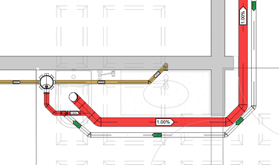

In a piping ssystem can be more than one systems conected? example:residual piping and ventilation piping

there are 2 options
1. Create an object that has 2 connections where you can set the MEP system. Then you can connect the routes to it
This object can be created from 2 MEP connections and then saved as a new MEP object
2. If you don't care about imperfection, you can just leave a small gap between them (0,1 units)

i do it with a 3 option, with an custom id for the ventilation pipe and graphic override, but only paint the label not the pipe
