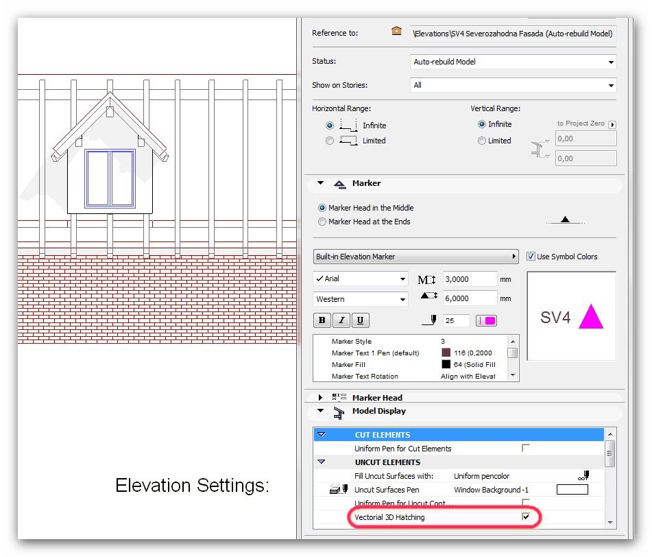

I can´t find the brick wall fill for illustrating the wall in my elevations. The only fill I have available in the wall default settings are the composite structure.
When I go into the element attributes: materials everyone comes up with "missing" in vectorial hatch. The the only thing I can choose is the fill type.
Why can´t I find more fills? I need the brick wall to show in my elevation. + edit it... Can´t find any similar posts or tips about downloading vectorial hatches or fill either. Please help me!

1. I have a lot of fills available
2. Check the Elevation Settings

If you have a template file, merge it into your current project.
If you know how, use the Attribute manager to bring all the default fills in.
If you don't, open a New & Reset All new file (Command+Option N), which will open a new blank file with the default fills.
... then save the blank file and merge it into your project
