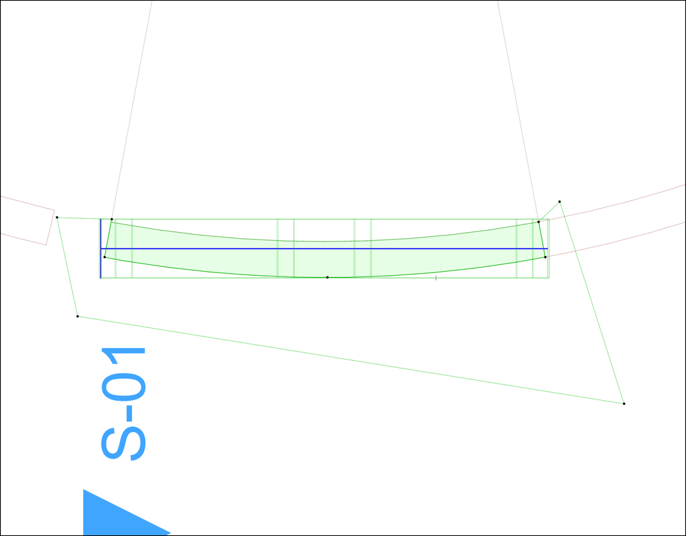

Hi everyone.
I have this particular structure to be modeled, but is a bit harder than simple column and beam method, because is curved all the way (as you can see from the top view). wall tool neither work, and maybe shell is only valid, but not sure how... any ideas? i can import as a object, convert it into morph but not sure if thats good, especially when construction stage is ready.
Thanks!

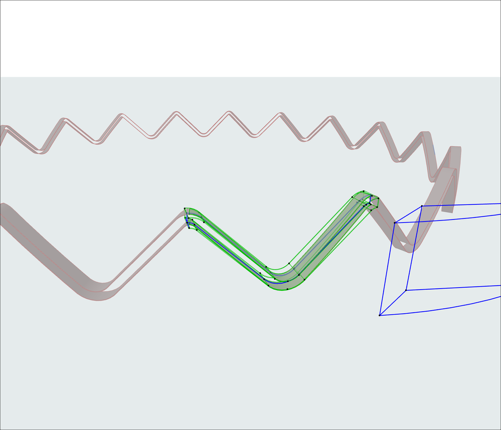

Definetly with a shell. I did a realy fast try out of curiocity with holes in a round shell to create the pattern and  then used the multiply-rotate increment for just the holes (you can do that)  to rotate the holes around the shell.
I feel that it can also be done with just  shells that trim each other to create the pattern and then multiply and rotate the pattern. this might be better because the section would be correct.
You can see in my picture that the pattern is distorted because I did it fast without considering accurate dimensions.
Following the scenario with the two shells you might need to create holes to cut some parts so it will look perfect.
Obviously with grasshoper might be simpler......

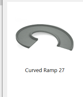

It resembles a ramp because of its curved nature. It may not be perfect, but you can test it with the several curved ramp.
Of course, importing is also good.
yeah, I just may leave it for now.. .
thanks tho!

I evolved the idea a little bit:pattern in 3d . this is one shell frame just for fun......It can be also a single mass shell.pattern in 3d . this is one shell frame just for fun......It can be also a single mass shell.multiply rotatemultiply rotatecreate the round shape with holes in the horizontal levelcreate the round shape with holes in the horizontal level
again not precise dimensions
